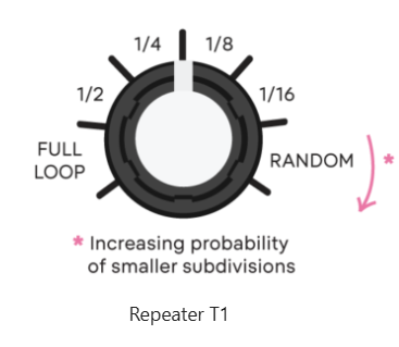

The same applies to:

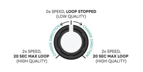

and this:
(here I would like to know the precise CCs for 1x speeds in both directions. What did you code for “9 o’clock” and “3 o’clock” normal speed positions? Also, is loop stop = CC val 63 or 64? Or both?

– MODE 3: repeater (T1)
elseif mode == 3 then
if midiVal <= 20 then displayText = “full loop”
elseif midiVal <= 41 then displayText = “1/2”
elseif midiVal <= 63 then displayText = “1/4”
elseif midiVal <= 83 then displayText = “1/8”
elseif midiVal <= 105 then displayText = “1/16”
else displayText = “random”

and then I think I just left the SPEED knobs to be an implicit “continuous” :sweat_smile:
