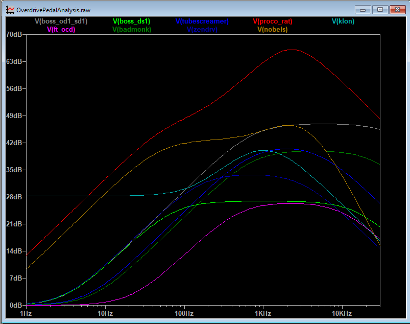

Here are some EQ curves from classic drives that I analyzed while making Sparks. You can see the low cut or shelf around 100–500 Hz and the upper-midrange bump around 1–3 kHz. Use LOW CUT to roll out some low end and the filter resonance to bump the upper mids and you’ll be in the right territory.

Wow, thanks for this super thorough response! I think I was on the right track with some of the stuff I was trying, but this is very useful. That OD response graph is also pretty interesting.
