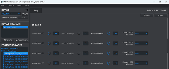

Really depends on the keyboard you get. If you get a Keystep for example, you can map the dials to whatever cc’s you want using the Arturia app. As long as you can do that send the appropriate values of the cc’s, you can plug directly into the ribbons. If you want Ableton to be in the middle, then you can do that too. The advantage of this is you can record midi automation in a track. Same thing but in this case, ableton sends the midi cc info to ribbons. You could in fact use ableton to send midi cc to the key step and midi thru to the ribbons. Hope this is making sense. Make sure you get a keyboard that can be programmed and can also send it out through the type of connector you ordered. Midi can be sent thru usb, din, or trs. I just set up a pirate midi pedal to do this directly to ribbons today, so I can change looper tracks and remotely hit the bypass or touch. You can do everything through midi.

You don’t need to use Ableton. If you’re looking for a simple setup to play the synth I agree that your best bet is a keyboard controller with a 5 pin DIN MIDI out. We like our KeyStep 37 - you can map the 4 encoders to any parameters via CCs (HP, LP, T1, T2 …)

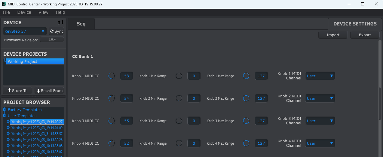

As @carl_cat said, the Keystep 37 is perfect for what you want to do. No Ableton required. Since you have the Kinotone adapter, you can plug the DIN MIDI out on the Keystep directly to Ribbons. You can play the synth and then customize what MIDI CC’s are being sent using Arturia’s MIDI Control Center. You could set up the four encoders to control HP, LP, T1, and T2. There are four “banks” so you could control up to 16 settings on Ribbons using just the Keystep 37.
