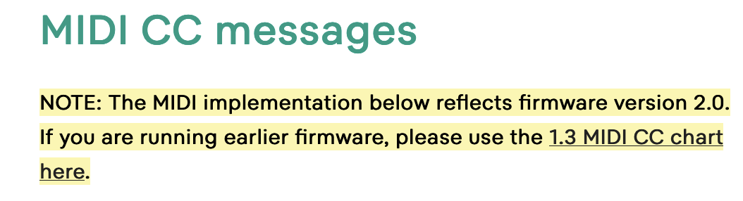

We overhauled all of the MIDI cc messages in firmware 2.0 to improve compatibility with more MIDI controllers.
It sounds to me like you are running the latest firmware but looking at the old MIDI cc chart.
Please refer to the MIDI cc chart in our online manual here.
(There is a note that links to the previous one for those running earlier firmware).
Thank you so much! I’m such a fool
