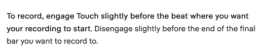

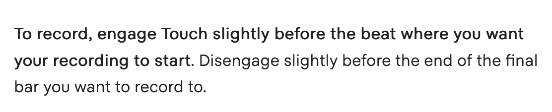

The timing we recommend is actually different if you’re synced to MIDI clock:
Part of what you’re noticing may also be that there’s a 5 ms fade-in on the first pass. This is intentional to avoid a jarring click or pop sound when the loop wraps around to the start, but it can sometimes shave off something transient-heavy.
Here is another approach that’s a lot of fun and can be more forgiving timing-wise:
Create an empty loop container, then overdub into it.
Engage the footswitch for 4 bars (just an example), then disengage slightly before the end of the 4th bar .
Engage the footswitch again to start overdubbing. You can really punch in to overdub whenever - just do so right after a downbeat.
In this scenario, any playing that you overudub stays synced with the original loop container, and since the fade-in occurs on silence it isn’t noticeable.
