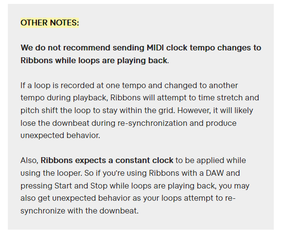

From the online manual:
If you want the looper to ignore midi tempo information (MIDI clock), then send MIDI CC 51, Value = 0. This will be remembered / persistent between power cycles.
