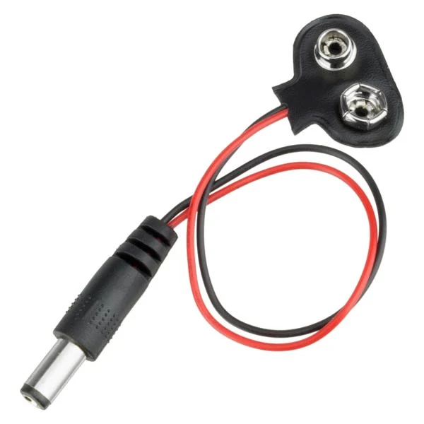

Ribbons does not have an internal 9V battery attachment. You’d have to use some sort of external 9V battery adapter like this:

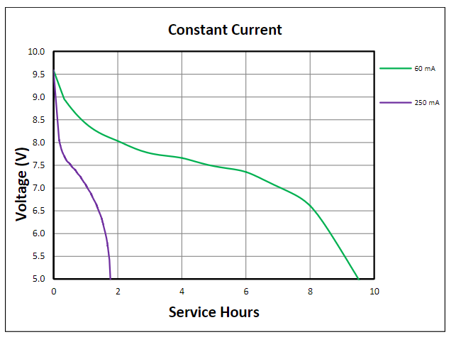

Let’s say we power it with a 9V battery from Duracell. We can use the “Constant Current” graph from the battery data sheet to see how it might perform when plugged into Ribbons:
Ribbons draws ~180mA of current at 9V, and ~250mA at 6V, and shuts down at ~5.8V. We can use the 250mA reference on this chart to estimate how the battery will decay over time. It looks like it might last about 1.5 - 2 hours on a 9V battery.
When the battery reaches 5.8V, Ribbons will crash or rapidly attempt to power on and off. In informal testing, the unit on my desk did not appear to be damaged when the battery drooped below 5.8V, but we cannot guarantee that long-term exposure to this undervoltage state is harmless. You could also experience reduced headroom once the battery begins to sag.
