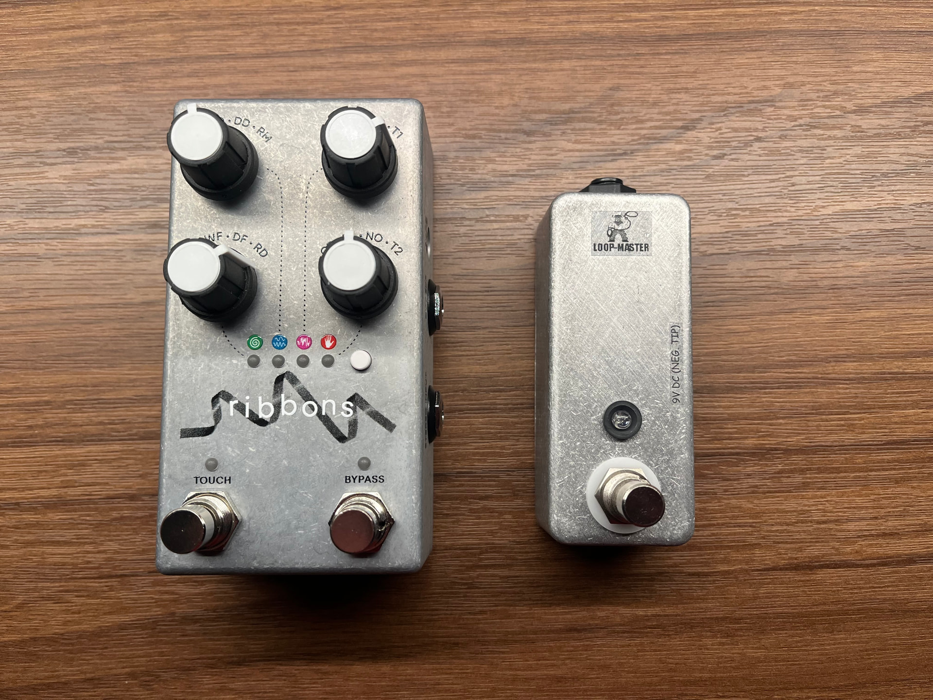

Before I read this, I had already ordered a CV foot switch from Loop Master:
Brian custom made this (my choice of switch and LED) and got it to me in a week at a very reasonable price. Very happy with it :grinning_face:

This looks neat ) I’ve had Loop Master make me a custom footswitch once (FS3X schematic). Can confirm it’s built to the highest quality standards, so congrats on this purchase.
So this is a CV footswitch, that sends +5V when pressed, and drops to 0V when released, correct?

I wonder how exactly your switch behaves? It has a power supply socket - is it only for the LED? What does the LED show? Is it ON when you press and OFF when you release the footswitch?
It’s latching, rather than momentary, although I’m sure he could make it the other way, if you’d like. I think I indirectly asked him if I could get it to behave like the Touch foot switch on Ribbons (ability to be momentary and latching, right?) and got the impression that it would be considerably more expensive.
Just for clarity - I click it, the light is on and I’m recording (4-Track Looper). I click it again, the light is off and the recording stops/starts playback.
I haven’t gotten a chance to try it without power. I’ll check on it and get back with you over the weekend.
You were right - power is just for the LED. Sorry that took so long to get back with you!
Thank you, this is interesting.
Emulating the “smart” way the Ribbons Touch FSW behaves (momentary if held, latching if pressed and released quickly) would indeed require some additional circuitry.
But yours is also smartly designed: it does what’s needed to tell Ribbons you’re switching the Touch footswitch (so it effectively toggles between Tip+Sleeve and Tip+Ring), while at the same time toggles the LED power in sync. This can be achieved without active electronics, using the proper DPDT or 3PDT switch.
