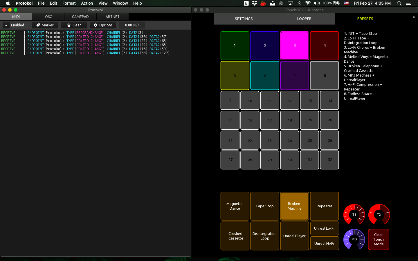

I’m starting working on the presets first, since that was something that 9lbsmax’s version didn’t have and corresponds to what I’m doing most at the moment.
Which leads me to a request for @jaakjensen. Ribbons doesn’t have a MIDI out port, so I have no way to make my TouchOSC template reflect my physical pedal’s knob settings. I wonder if Jaak could share the settings of all seven presets – either as knob mappings or better, simply as MIDI parameters? I imagine this would be useful for Ghosts and Sparks, as well.
Here’s what I have written so far after a couple of days reading up and another couple coding. I’m still trying to figure out how to map the presets onto the Touch Modes and T1 and T2 knobs. That is, when I select, say, the Lo-Fi Chorus preset, have the Broken Machine Touch Mode button light up (and dim the others) and set the T1 and T2 knobs to the proper initial values for that preset. On other pages (which don’t exist yet), I’d want the preset to set the other knobs appropriately.

i’ve just starting playing around with TouchOSC and have built some templates for my other pedals (some Chase Bliss and OBNE; https://patchstorage.com/author/tbird5000/ for the curious).
i’m new to Kinotone, but i have a new Ribbons on the way so i had already started thinking about designing a template and it’s awesome to see this project already underway. my stuff tends to be very rudimentary, but the lua scripting is such a powerful tool for customization (i really like it for making scripted labels and ‘reset’ buttons). and i feel your pain in trying to suss out CC values when the midi only goes 1 way (i found this especially true when trying to figure out the 12/noon ‘deadzone’ on a knob that has subtle but different effects on each side).

I downloaded your OBNE Sunlight (an awesome pedal!) template from Patchstorage last week but haven’t had a chance to try it out yet. My intention, actually, was to see how you approached its design. Of course, I fully intend to try it out too and benefit from your work.
I also grabbed your Mood MKii template, although I don’t have that pedal yet. Again, I was curious about the design and how CBA pedals work with MIDI. I may hack something together for my Thermae and BAM once I get further into TouchOSC.
Patchstorage seems like it should be a good resource, although none of my other MIDI capable pedals are represented there. Once I have my template a bit more fleshed out, I intend to upload it there.
oh nice! yeah please feel free to give my templates a whirl, reuse bits and pieces and let me know if you have any suggestions or encounter a issue. they’re very much a work in progress, but i’m probably happiest with the CBA Lost + Found template right now. i’m mostly approaching these from trying to mimic the physical layout while surfacing the hidden features (and with the scripted labels hopefully eliminate some of the instructions-manual diving).
and yes- patchstorage is a great place to share, but it is admittedly bit hit and miss when it comes to effects pedals. fortunately TouchOSC uploads seem to be picking up a bit! and the good news is once you have one working template, a lot of the work is preserved for the next…which reminds me i have a OBNE Dark Star i’ve been meaning to finish :smile:
