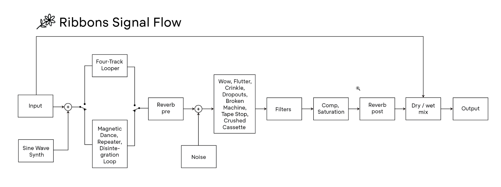

From the Ribbons manual page:
Just realizing this diagram is out of date after the 2.0 update.
I’ll add updating it to my list of to-do’s.
Tape effects are applied to recorded loops. So the effects come after the loops in the signal chain.
Yes, the input signal chain is generally:
Input → mixed with sine wave synth → four track loops → touch modes
